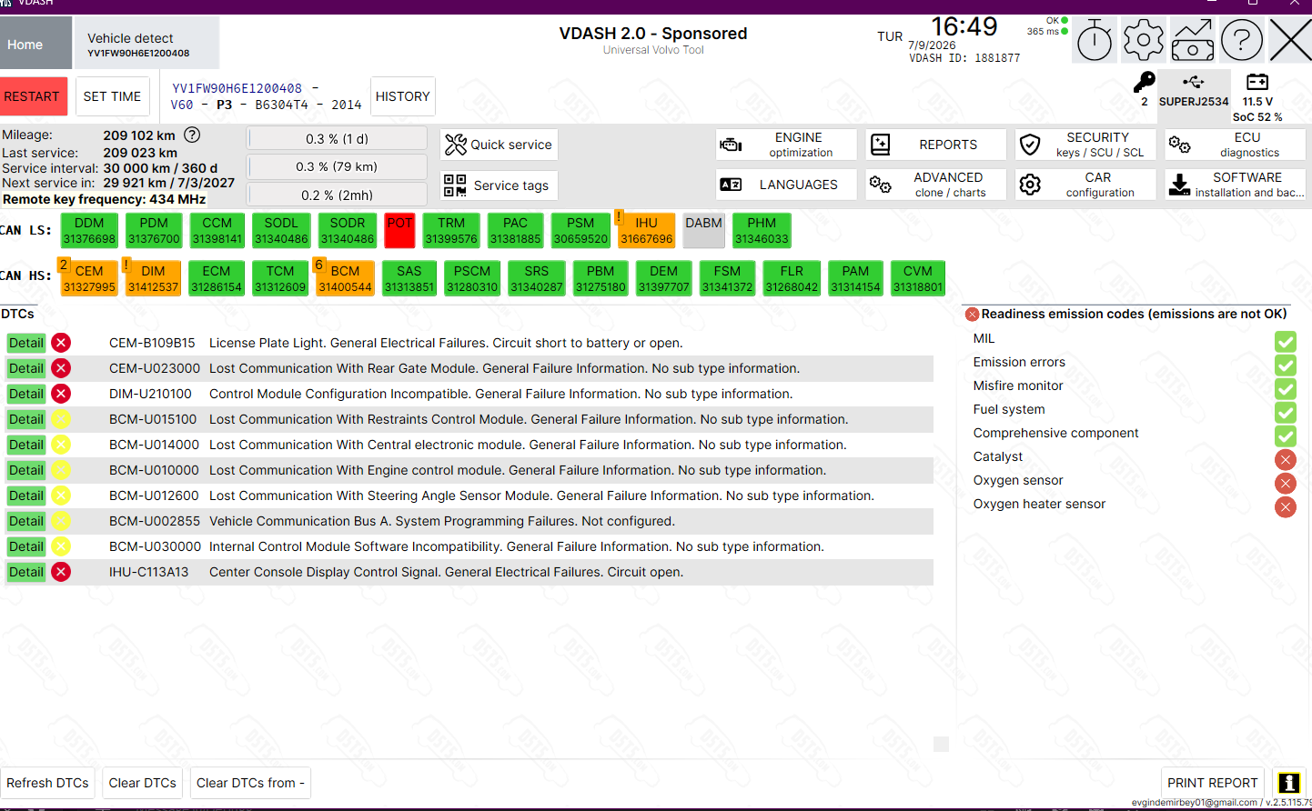

<?xml version="1.0" encoding="UTF-8"?><rss xmlns:dc="http://purl.org/dc/elements/1.1/" xmlns:content="http://purl.org/rss/1.0/modules/content/" xmlns:atom="http://www.w3.org/2005/Atom" version="2.0"><channel><title><![CDATA[Hill Descent Control Retrofit fail]]></title><description><![CDATA[<p dir="auto">Im having problems retrofitting Hill Descent Control in my 2014 V60 3.0 T6 AWD R-design with polestar optimization. I have seen this retrofit done on older and newer S60´s and V60´s so I thought it would be possible but no. So the problem is the following: For Hill descend control to work, I know that the car has to be AWD which I have and also the HDC button needs to be installed in the center control stack and that the automatic transmission has to be in first gear in manual mode. What I have done is, I installed the button on the center stack where it was blank (bought the button online, removed the blank and put the button there), then activated the HDC via a different software, similar to V-dash which I wont mention the name of, synced both BCM (Brake control module) and EPB (Electronic parking brake) module to the current car config, then tried it.</p>
<p dir="auto">It didnt work, the light on the button didnt want to light up. Then I deactivated HDC and activated Hill Start Assist, synced BCM and EPB again, and Hill Start Assist worked. Then I activated both, Hill Start Asist and Hill Descent control, only Hill Start Assist worked. The HDC still didnt want to work. After that I realized, after refreshing the DTC´s in V-dash (after trying to activate HDC), the BCM would throw a lot of errors. One error I noticed is the incompatibilty. What Im wondering is,  is this a hardware problem or a software problem? Because I synced the BCM and EPB to the current car config after activating each so I dont know what more to do. And my car is Automatic with AWD which is whats needed for HDC. I dont udnerstand it <img src="/assets/uploads/files/1783619592286-v-dash.png" alt="V-dash.png" class=" img-fluid img-markdown" /></p>
