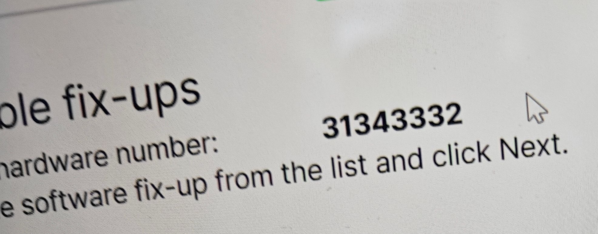

<?xml version="1.0" encoding="UTF-8"?><rss xmlns:dc="http://purl.org/dc/elements/1.1/" xmlns:content="http://purl.org/rss/1.0/modules/content/" xmlns:atom="http://www.w3.org/2005/Atom" version="2.0"><channel><title><![CDATA[Dim-u300045 Volvo xc60 2013]]></title><description><![CDATA[<p dir="auto">Hi there. I have a Volvo xc60 which millage has been rolled back and now the Dim module shows the dim-u300045.<br />
I know there is an option withinn VDash but when I press on it shows no fix available. Could some help me and guide me through the fix?<br />
Thank you in advance<img src="/assets/uploads/files/1784614993541-1000051042.jpg" alt="1000051042.jpg" class=" img-fluid img-markdown" /></p>

]]></description><link>https://forum.d5t5.com/post/1441</link><guid isPermaLink="true">https://forum.d5t5.com/post/1441</guid><dc:creator><![CDATA[Atlantic28]]></dc:creator><pubDate>Tue, 21 Jul 2026 16:37:00 GMT</pubDate></item><item><title><![CDATA[Reply to Dim-u300045 Volvo xc60 2013 on Tue, 21 Jul 2026 14:38:48 GMT]]></title><description><![CDATA[<p dir="auto"><a class="mention plugin-mentions-user plugin-mentions-a" href="https://forum.d5t5.com/uid/1451">@Atlantic28</a> create a support ticket <a href="https://d5t5.com/helpdesk/create/ticket" rel="nofollow ugc">here</a> and ask if they can prepare a software reload for your DIM. Maybe there is no automatic fix for your software version yet.</p>
