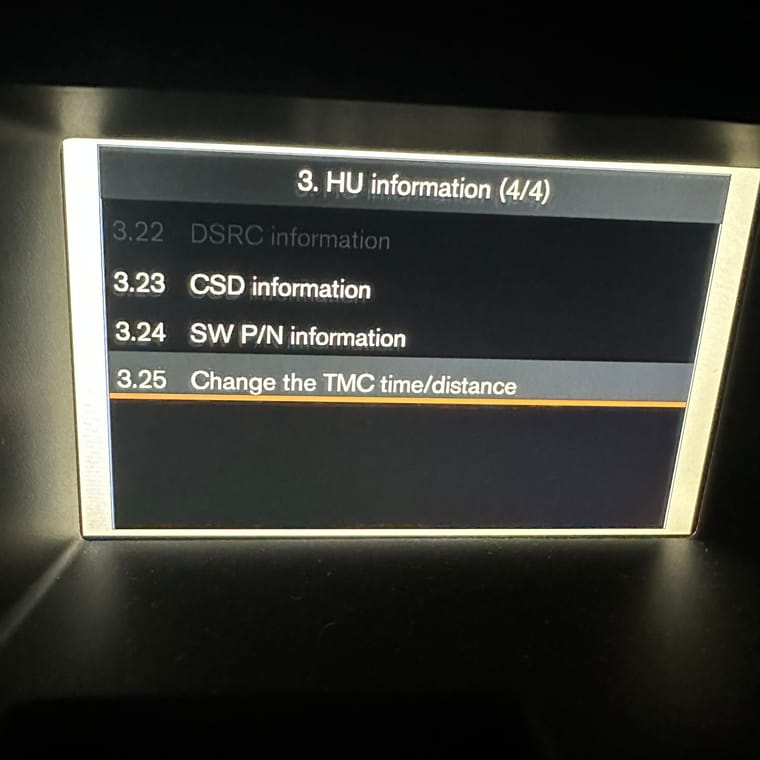

<p dir="auto">I performed a USA → EU conversion using VDASH on my Volvo XC60 MY2015.</p>
<p dir="auto">The radio and Polish language are now working correctly.</p>
<p dir="auto">I currently have two remaining issues:</p>
<ol>
<li>Navigation map region</li>
</ol>
<p dir="auto">I followed the D5T5 instructions for changing the navigation region. The Market/DVD settings are set to EU, PAL, Region 2 and AM/FM EU.</p>
<p dir="auto">However, in my IHU Engineering Mode, 3.25 is the last available item. Menu 3.26 “Map update information” is completely missing, so I cannot enable “Different region map update” and therefore cannot install European maps.</p>
<p dir="auto">How can I enable menu 3.26 / Different region map update on my IHU?</p>
<ol start="2">
<li>Remote window opening/closing</li>
</ol>
<p dir="auto">After the USA → EU conversion, opening and closing the windows using the remote key is still not working.</p>
<p dir="auto">How can I enable remote window opening/closing in VDASH?</p>
<p dir="auto">Could these two issues mean that my USA → EU conversion was not fully completed?</p>
<p dir="auto">I would really appreciate your help.</p>
