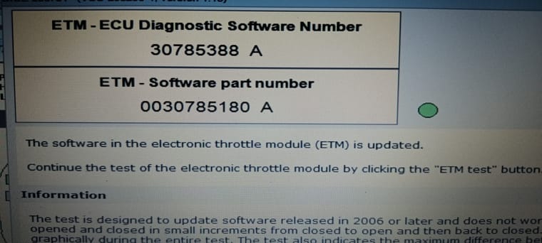

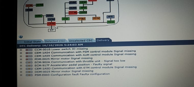

<?xml version="1.0" encoding="UTF-8"?><rss xmlns:dc="http://purl.org/dc/elements/1.1/" xmlns:content="http://purl.org/rss/1.0/modules/content/" xmlns:atom="http://www.w3.org/2005/Atom" version="2.0"><channel><title><![CDATA[Another Magneti Marelli ETM question]]></title><description><![CDATA[<p dir="auto">Owned the 2001 XC70 for 10 years, did the Sacer contactless 8 years ago. Whats the likelyhood the Magneti Marelli ETM is dying or is it wiring/another module.</p>
<p dir="auto">CONFUSING fault codes. Getting Accelerator low signal 902A <img src="/assets/uploads/files/1792287993080-whatsapp-image-2026-10-17-at-21.37.23-resized.jpeg" alt="WhatsApp Image 2026-10-17 at 21.37.23.jpeg" class=" img-fluid img-markdown" /></p>

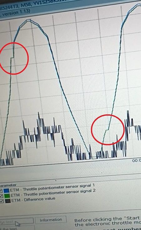

<p dir="auto"><img src="/assets/uploads/files/1792288031521-etm-test-glitch.jpg" alt="ETM test glitch.jpg" class=" img-fluid img-markdown" /></p>
]]></description><link>https://forum.d5t5.com/topic/443/another-magneti-marelli-etm-question</link><generator>RSS for Node</generator><lastBuildDate>Sun, 18 Oct 2026 05:33:58 GMT</lastBuildDate><atom:link href="https://forum.d5t5.com/topic/443.rss" rel="self" type="application/rss+xml"/><pubDate>Sun, 18 Oct 2026 01:50:49 GMT</pubDate><ttl>60</ttl><item><title><![CDATA[Reply to Another Magneti Marelli ETM question on Sun, 18 Oct 2026 02:13:34 GMT]]></title><description><![CDATA[<p dir="auto">Threw in a used contactless throttle pedal at car and no change, checked +12v and ground all appears good. Internet in Australia is notoriously bad, sometimes no drops outs sometimes many. In the ETM test graph what could cause the glitches, i had the ETM removed and watched the butterfly valve hesitate, i do not believe its rubbing/binding   <img src="/assets/uploads/files/1792288808833-whatsapp-image-2026-10-17-at-22.02.59-resized.jpeg" alt="WhatsApp Image 2026-10-17 at 22.02.59.jpeg" class=" img-fluid img-markdown" /></p>
