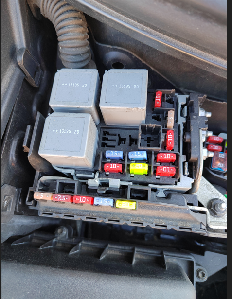

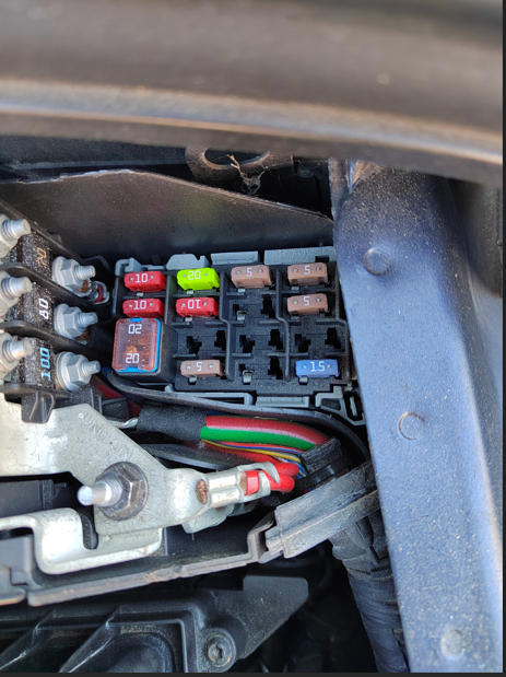

    Here are the pictures of the fuse box in the engine compartment. Does anybody knows the location of the fuse and relay for AC clutch?
      SU-AM
      Pictures are in the thumbnail.

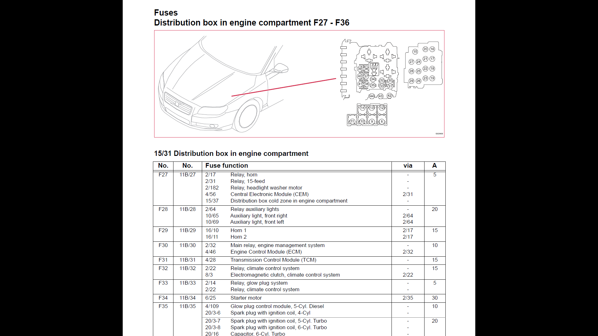

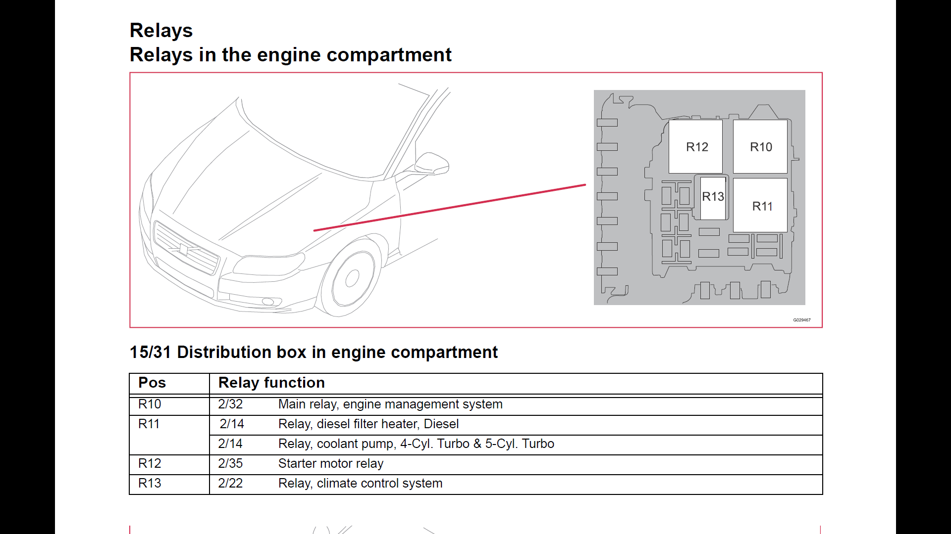

          replied to SU-AM on last edited by
          @SU-AM the complete wiring diagrams with everything regarding electrics for your car can be found here https://vidaresources.volvocars.biz/ewd/Eng/index.html
