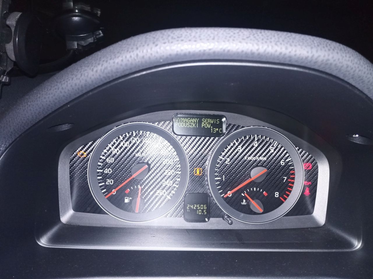

                Now i have this strange situation where SRS code (SRS-0128 CAN Signal) was cleared with vdash, and doesnt return, but on DIM, there is still message:airbag service requiered.srs.jpg (no word urgent).
                Actually, it kinda reminds me situation with my EGR.I had it physically blocked, and of course there was DTC for that. I kept deleting it with generic elm327 and it kept returning after less than 30 kilometers. Then i cleared it with VDash, and hasnt returned for over 1000 km. How is this possible? EGR wasnt programmed out of car.
                  replied to nesaru on last edited by
                  @nesaru that's really strange. Did you try to disconnected the battery for at least 1 hour? The code means no communication between SRS and CEM, or incorrect CEM configuration. Maybe your seatbelt reminder config is incompatible with your car. Vdash has no compatibility checks for this, so you could have applied a wrong/incompatible config.

                    @T5-T6-Schnappi thanks for your assisstance. Indeed, you were right with car incompatibility with new settings. I got new charger today and reverted belt reminder to original (Euro NCAP), and message was immediately gone.
                    Thanks!
