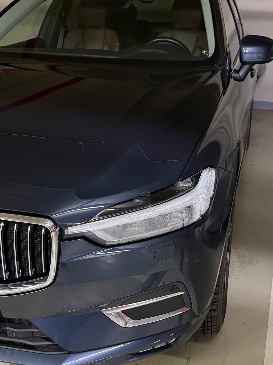

    During winter, I took the car to a regular car wash. After washing, I parked it overnight in a warm underground garage. The next morning, when I came back to the car, I noticed visible condensation inside one of the headlights — clearly moisture trapped inside the housing. At that point, it was obvious that water had somehow entered the headlight assembly 👇
    The issue did not resolve on its own.
    The headlight would partially dry out over time, but only temporarily. As soon as I drove again in humid or wet conditions, the condensation returned to a similar level. In other words, the moisture was never fully gone — it kept coming back depending on the environment.

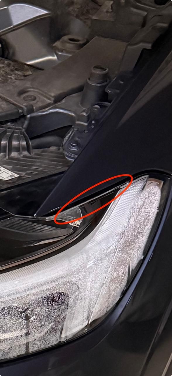

    The dealer performed the diagnostic in about 5 minutes, which immediately made me think that this might be a fairly common issue, as the root cause was identified so quickly — especially considering that it is not detectable with the naked eye.
    They showed me a loss of sealing between the headlight housing and the lens. By gently pressing on the plastic in that area, a small gap became visible, clearly showing that the seal had weakened. Most likely, this happened due to sealant fatigue over time and vibration.
    There were no visible signs of impact or damage, so this issue would be almost impossible to notice without a detailed check.

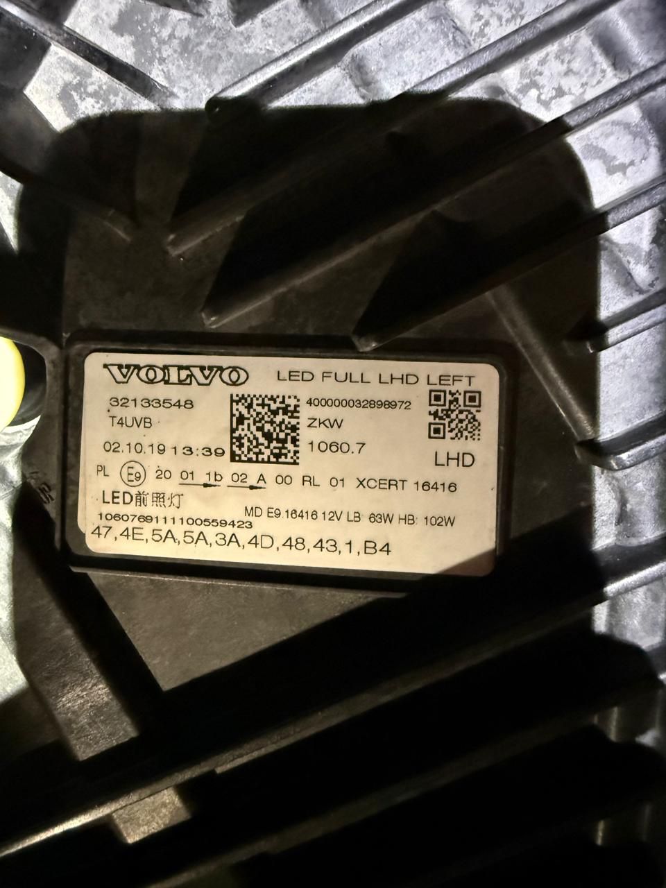

    PS. I’m attaching a photo of the affected headlight, including the part number:
