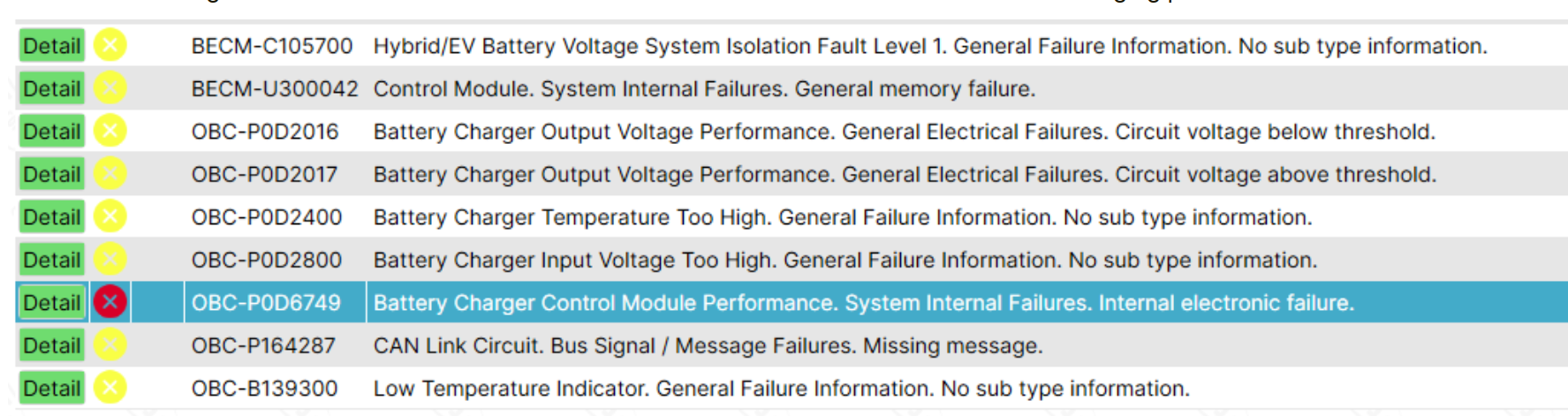

    The other day when I plugged the charging cable in to my V60 2015 hybrid I got a steady red light from the charge port and the car is not charging.
    I have the following fault codes, + a few others, but these seems to be the ones connected to the charging problem
    When running the car it uses the electric motor and it seems like the battery charges when breaking and also if the save button is enabled.
    To me everything points to a broken charger, or could it be something in between like inverter from AC to DC?
    Anyone has any experience with the same faults?

      Car is finally charging its batteries again on the land line.
      After a lot of investigations on what chargers would fit the car, there is a bunch of different part numbers on the OBC for the v60, I ordered a used charger from the scrap yard. Internally and communication vise they should be basically the same and are interchangeable. However there are different lengths on the cables. My charger had the number 30659929 on it, but the one I ordered had the number 32202164. Turned out the AC cable and the cable to the DC/DC converter where shorter on the new charger one so I just swapped the lids on them. After resetting the error codes the car is now on the drive way charging its batteries and is soon ready for test drive.
