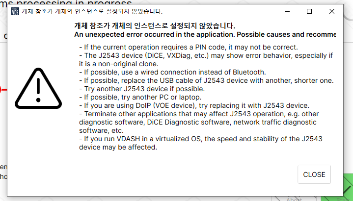

I attempted to perform an SCL disable using vdash(with mongoosepro jlr), but I’m stuck. While other car configuration changes are working perfectly, the SCL disable process fails with an error (please see the attached screenshot).

Is it impossible to proceed with the SCL disable while the TFT DIM is installed?
Do I need to temporarily reinstall the original (old) DIM to complete the SCL disable process?
If you’ve experienced this specific conflict between a TFT retrofit and SCL service, I’d love to hear your insights.
