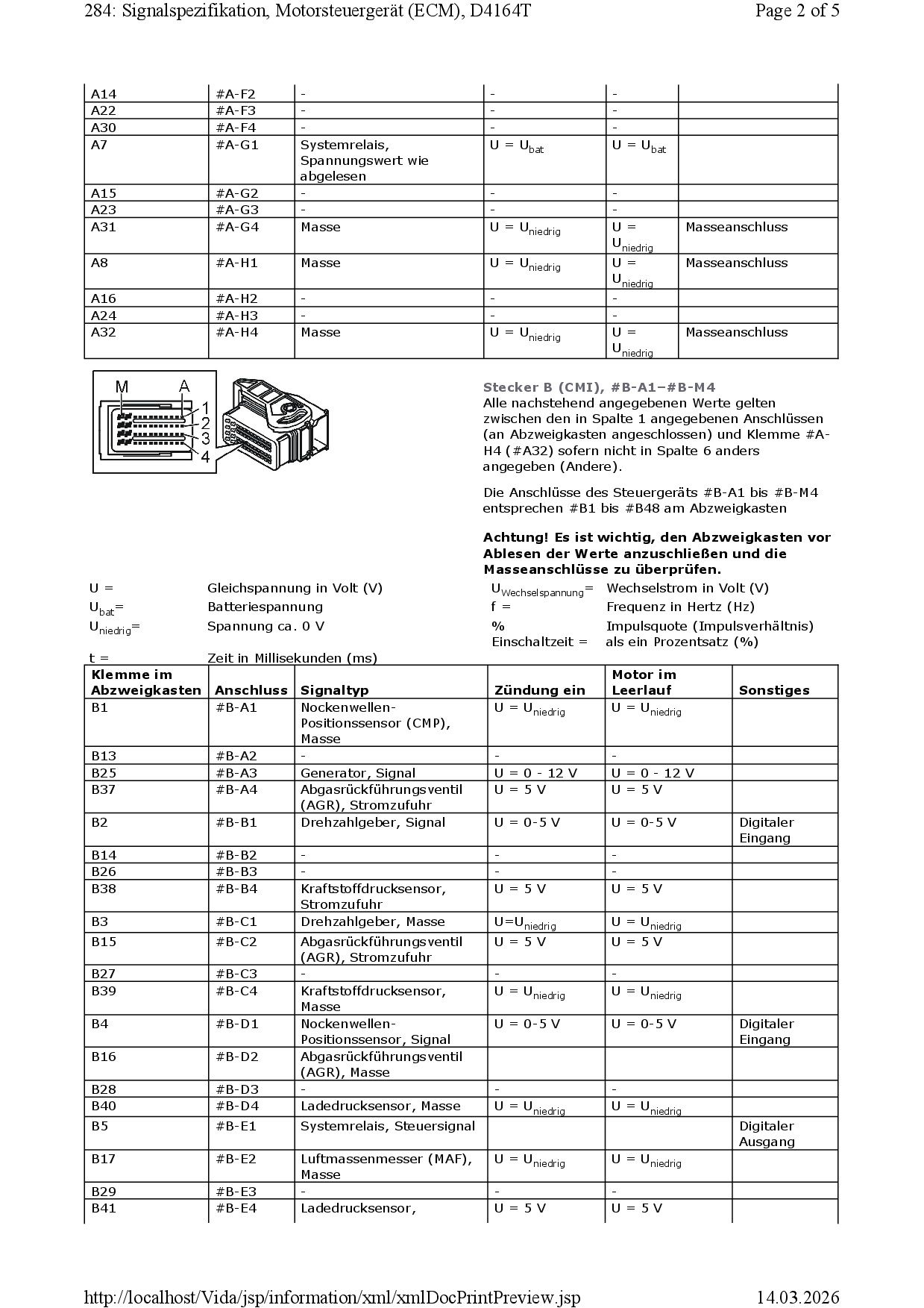

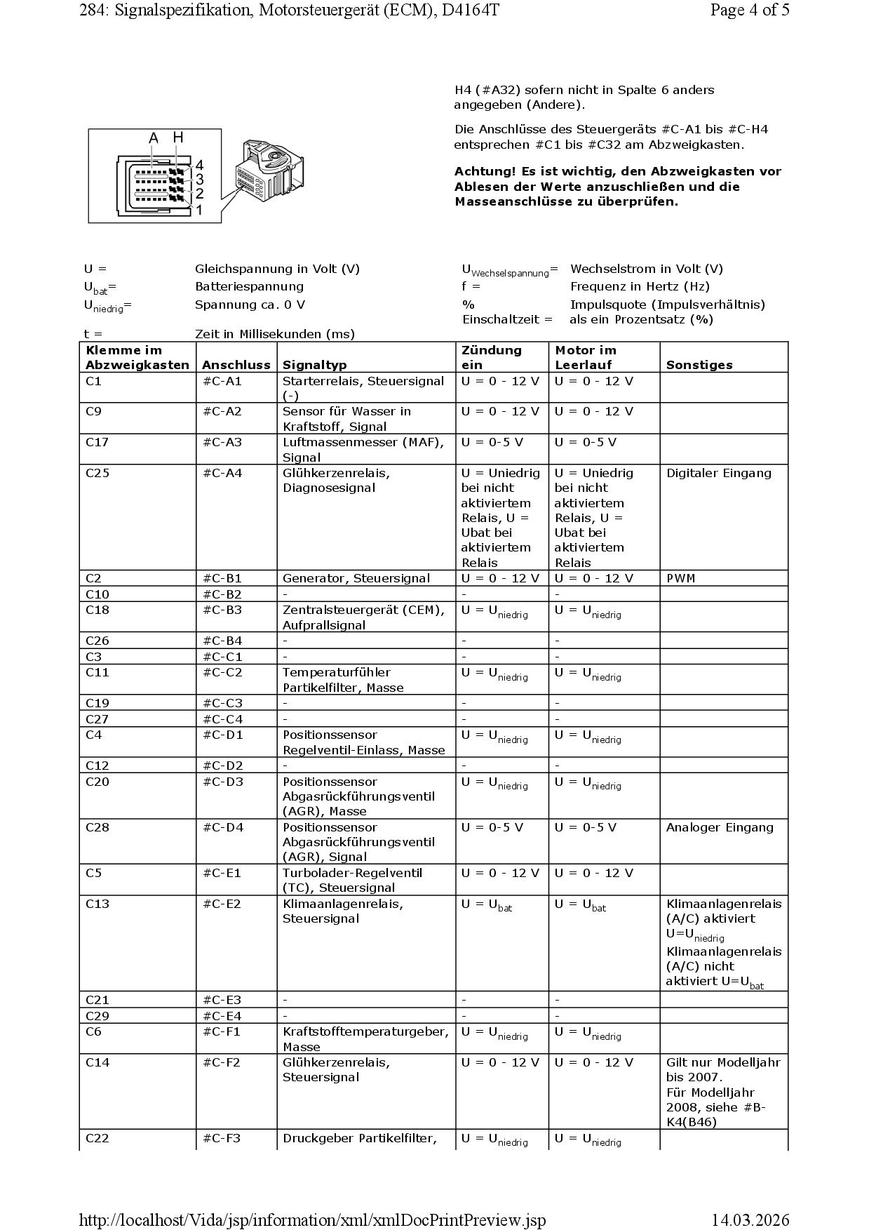

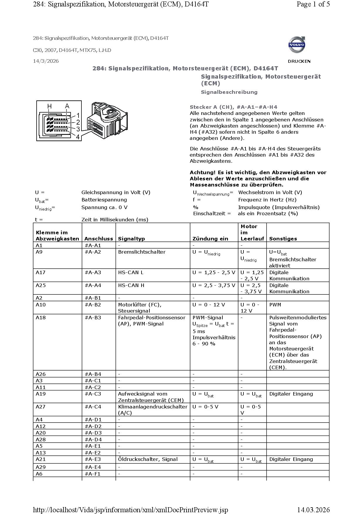

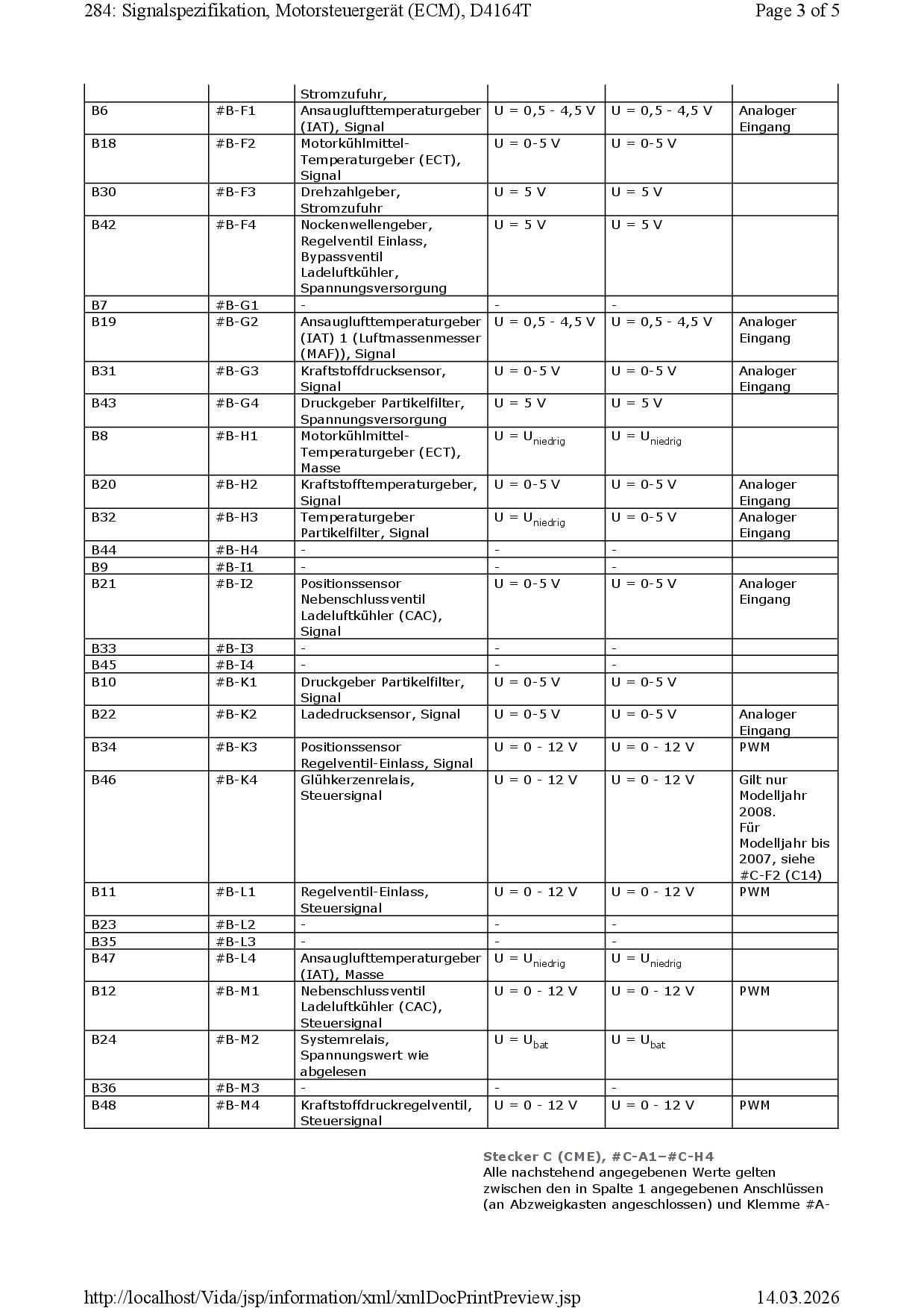

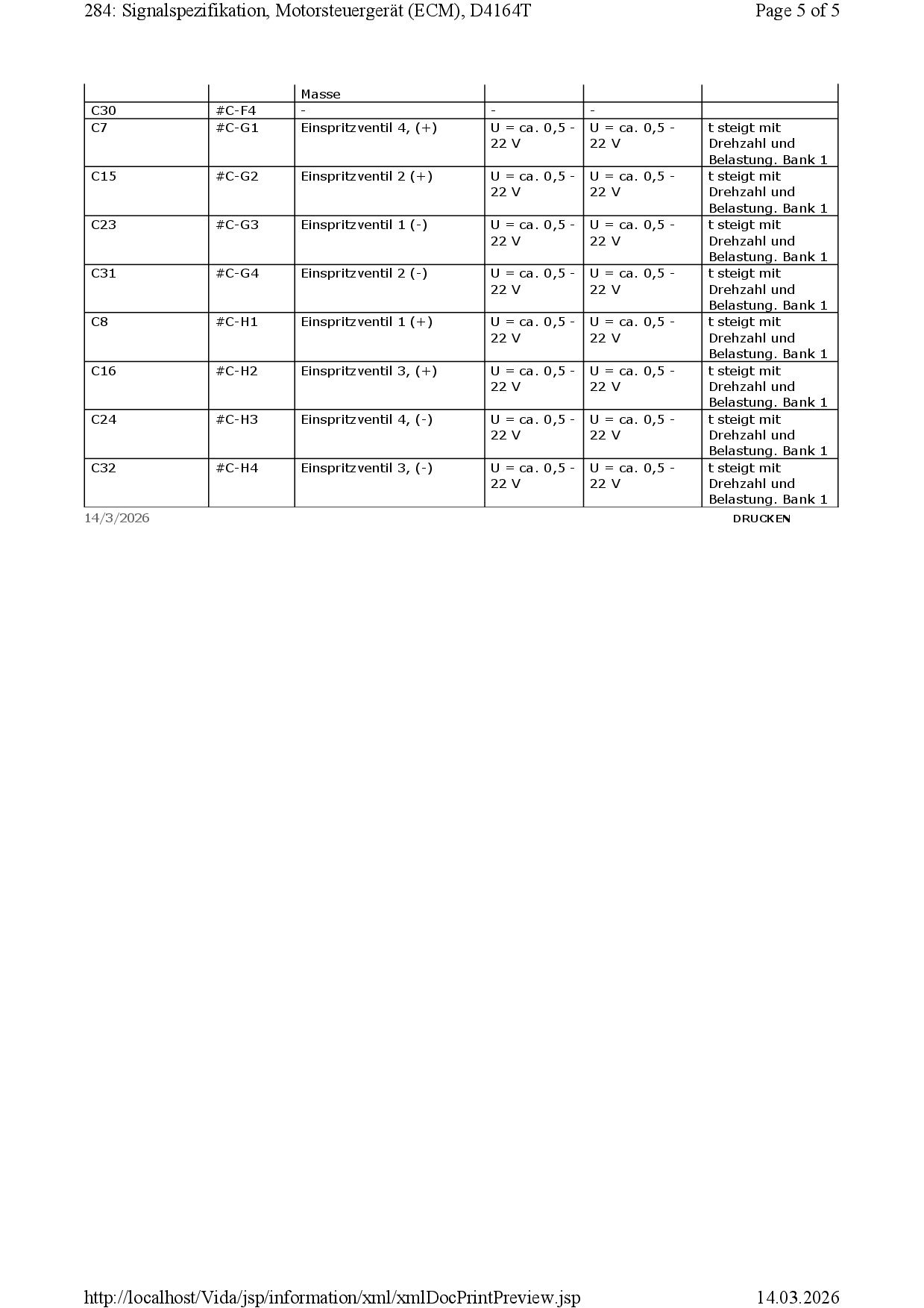

        replied to unysea on last edited by
        @unysea Here is the pinout in german anyway 😉
        C30 ECM-0001.jpg C30 ECM-0002.jpg C30 ECM-0003.jpg C30 ECM-0004.jpg C30 ECM-0005.jpg
