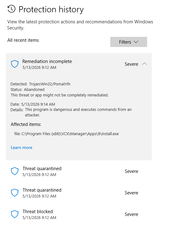

    I recently downloaded a file from https://www.vxdiag.net/ following the instructions in this link https://d5t5.com/article/generic-j2534, and Windows security flagged it as containing a Trojan.
    Please look into this matter and take the necessary actions to ensure the file is safe.

      @bochenn that's a false alarm and nothing to worry about. This is known to happen since ages. D5T5 can do nothing about this. And the guys from Vxdiag don't care at all about this. Restore the file from the quarantine and allow it to be executed. If you feel unsafe about this, return your adapter and get a better one. Vxdiag/Vxnano are absolute crap anyway.
      You will have to run the Vxmanager every 4 weeks to renew the license, or the adapter won't work.

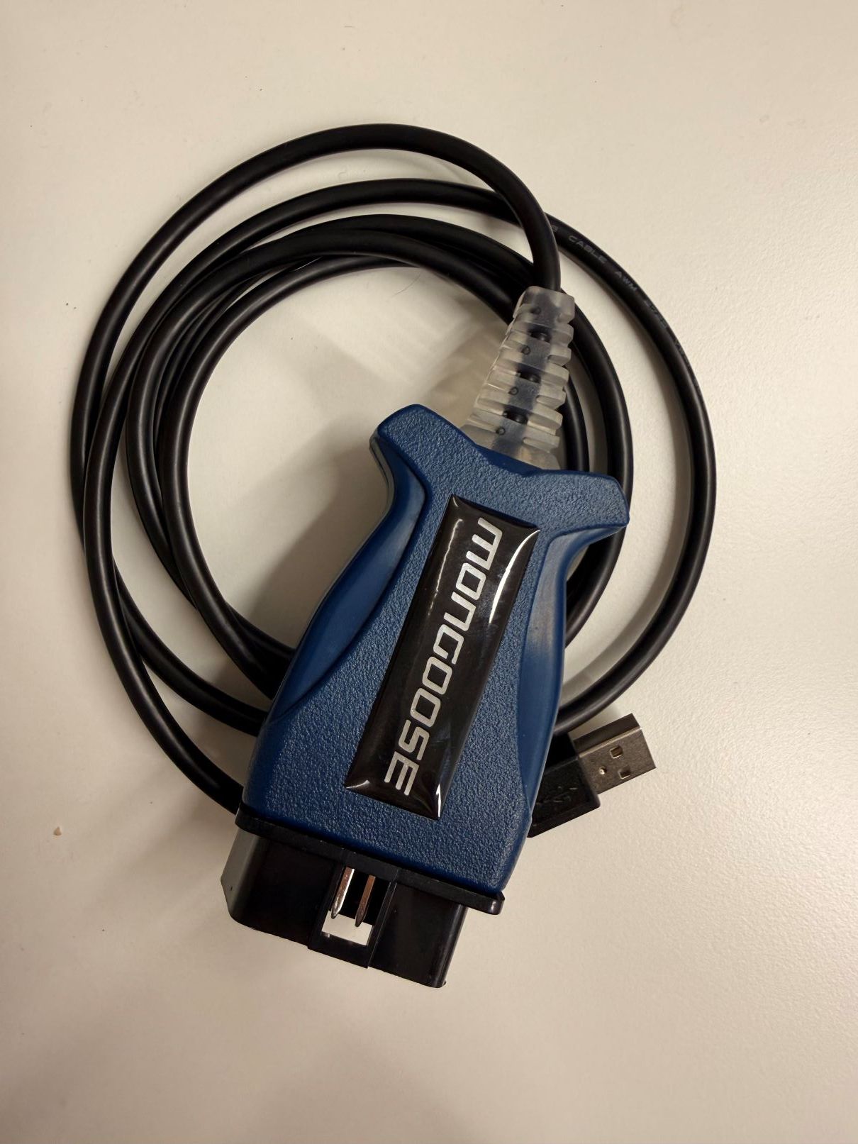

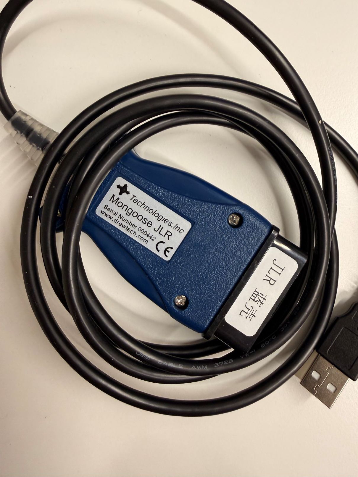

            @T5-T6-Schnappi Thanks! Should I get a different cable than a Mongoose? Attaching picture of the cable.
            Thanks!

              @bochenn A Mongoose / Super J2534 is the best option for most P80, P1, P2, P3 plattform cars and will also work on SPA cars. A so called full chip DICE clone would be slightly slower but also okay.
              Does your current adapter look like the one on your photos? If yes, which name does it report in the Windows device manager in the vehicle pass thru device section when it's connected?
              If you intend to buy any adapter from Aliexpress or equal chinese shops you must be prepared to receive low quality parts that look like the original but don't work as expected. A good Mongoose clone with the original Atmel chipset or a good 1:1 DICE clone will never cost 2 digit amounts of money. At least not in Euros.

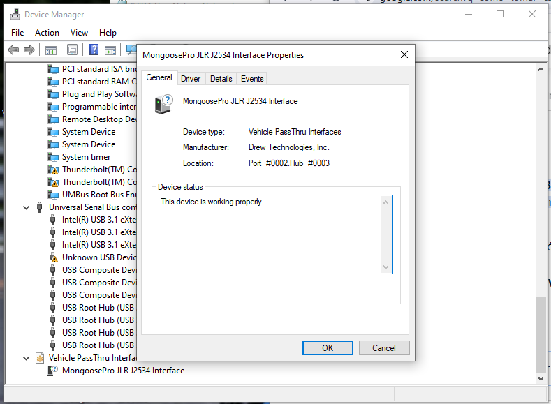

                @T5-T6-Schnappi hey thanks for all your answers, very helpful. Here is the info from Windows Device Manager:
                I got this cable from https://diaglaptops.com/wp/vida2go/
                I guess is not a good one?

                  @bochenn that's a trusted source for good adapters and also a Vdash Pro partner. So this adapter should be really good for P1, P2, P3 and also SPA cars.
