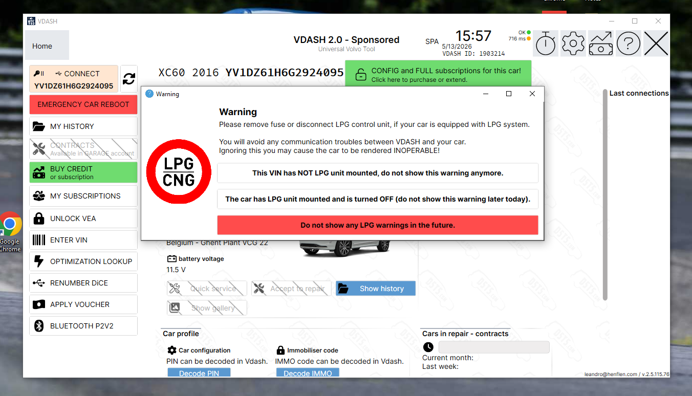

    Yesterday I tried to use VDASH for the first time and after login I got this message:
    Warning
    Please remove fuse or disconnect LPG control unit, if your car is equipped with LPG system.
    You will avoid any communication troubles between VDASH and your car.
    Ignoring this you may cause the car to be rendered INOPERABLE!
    So as you can imagine, I closed VDASH and used VIDA.
    Can you tell me what is that and how to proceed?

      @bochenn Does your car have LPG/CNG? If not, ignore this warning, it's a generic warning as some cars similar to yours are equipped with aftermarket LPG/CNG units, that can and will interfere with the operation of Vdash. Click on "This VIN has NOT LPG unit mounted, do not show this warning anymore." and forget that you saw this message.
      If you have LPG/CNG pull the associated fuse and select "The car has LPG unit mounted and is turned OFF (do not show this warning later today)."
      If you are sure that you will never connect any car with LPG/CNG to your account select the last option.
