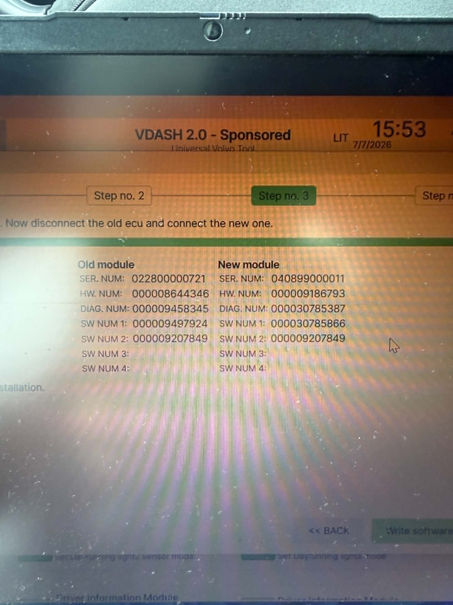

                  @T5-T6-Schnappi Thanks for advice, i borrowed other cable and everything worked out. Also it works with different part/hardware numbers too( added picture). If it will be useful to anyone, it is enough to buy ETM by model year, the codes may differ.
