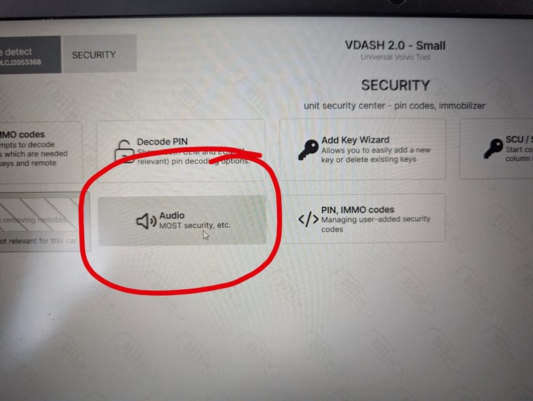

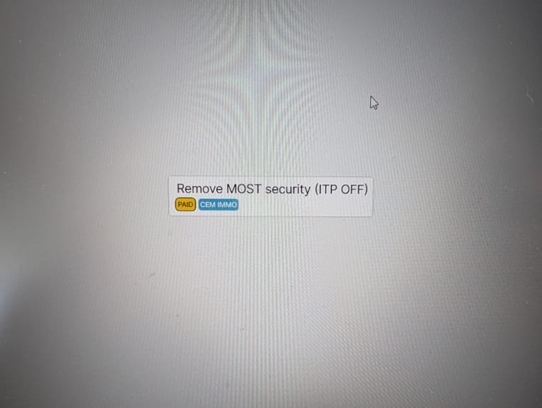

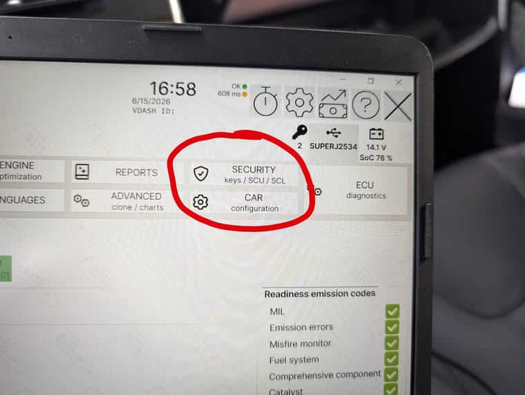

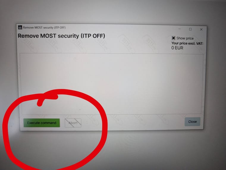

                    @Remusrahau if you haven't bought the config or ultimate flat, you will first need to add credits(22EUR) to your account via the money button in the top right corner.
                    I recommend to connect a charger to your battery.
                    After connecting your car and waiting for all modules to load click on Security
                    Click on Audio
                    Click on Remove MOST security
                    Click on Execute command
                    After the process has finished, shut off the car, lock it and leave it alone for at least 15 minutes.
                    ITP should be off now.
