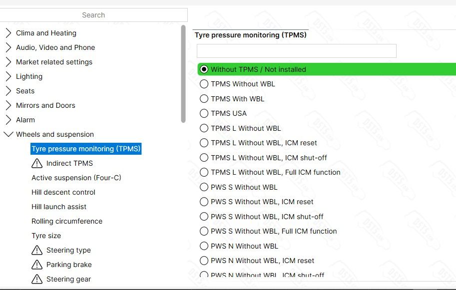

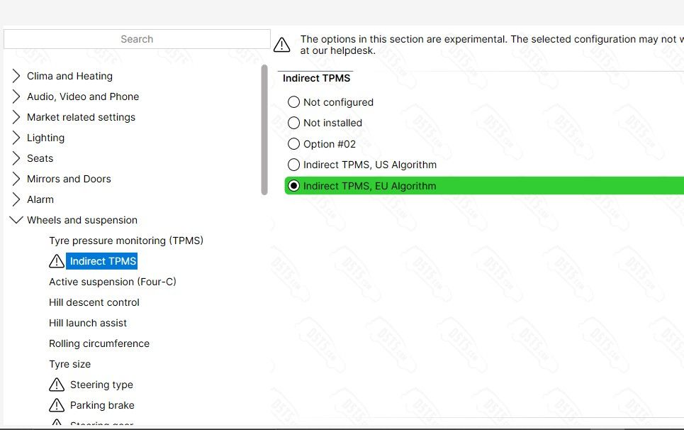

    I also tried changing the configuration to:
    Tyre pressure monitoring (TPMS) → Without TPMS
    Indirect TPMS → Not installed

        @Bartas222 the factory configuration for iTPMS looks like this.
        After changing any parameters with Vdash you have to shut down the car and lock it for at least 20 minutes to make sure the changes get properly applied.
        The tyre monitor should be visible as seperate menu under "My Car".
