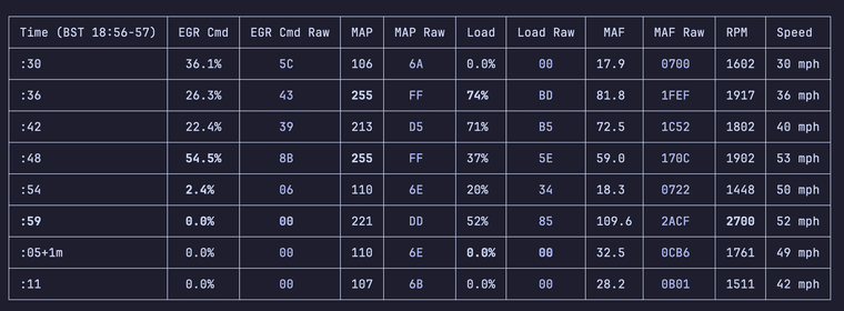

          This is the latest run after clearing the P0100 and the adaptions on Throttle and EGR:
          the exact fault sequence with raw hex:
          17:56:48 — EGR still working (54.5%, raw 8B), MAP at 255 (FF), speed 53 mph
          17:56:54 — EGR drops to 2.35% (raw 06), EGR Error -3.91% (raw 7B), MAP drops to 110
          17:56:59 — EGR goes to 0.0% (raw 00) — this is the kill moment. RPM 2700, MAP 221, MAF 109.6 g/s, pedal 49%
          17:57:05 — EGR stays 0.0%, Engine Load drops to 0.0% (raw 00) — tortoise mode active, speed 49 mph but decelerating, pedal
          released
          The exact trigger sequence at raw level:

            #10
              #11
              The problem seems to start when to the EGR is closing. As your MAF is reporting different values, this part is working and not the cause of your problem. Your data is lacking the pressure from the MAP sensor(s). There is one in the intake manifold that you should a look at as described here https://d5t5.com/article/vea-d5-clogged-boost-pressure-sensor and there is maybe a second one in the intercooler, that you should also clean. Then you should do a smoke test of whole intake and charge pipe system. There seems to be leak, or it's just the MAPs are dirty, also take a closer look at the EGR pipes. These are known to crack from time to time.
