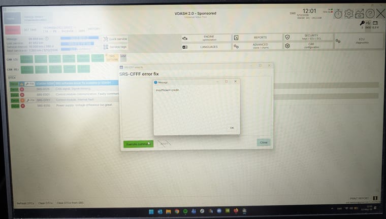

    @T5-T6-Schnappi Thanks for the reply.
    I clicked the "Clear DTCs" and the codes in the picture were the ones that were left. Both "Fix" buttons for VDASH-5004 and SRS-CFFF leads to the same "execute command" window that that doesn't bring up the basket and the pricing.
    Do you mean I should press the "Clear DTCs from SRS"? I got warning signs when i pressed that and it said that you should really know what you are doing before clearing those (something about potentially exploding airbags).

    Hi!
    I am trying to "fix" SRS CFFF error on volvo c30 2009 1,8f.
    After booting vdash it recognizes the car and shows I have an error with the SRS CFFF, which was caused by a bad battery that has since been replaced.
    When I click the "fix" button an empty window pops up which says "execute command". Clicking this only answers that there are "insufficient credits". But I can't see the shopping cart with the pricing after clicking fix like others can as I've seen in youtube videos and pictures of vdash in use.
    I have tried making another account, uninstalling and reinstalling v-dash, loading in minimum amount of credits to try to trigger the shopping cart. It says with my account type that I will see ads but I have not seen any ads, if that tells anyone anything. Wrong account type for home personal use with just one car?
    I have:
    Free account (sponsored)
    Latest version of VDASH v.2.5.115.76
    DiCE adapter to usb
    Latest drivers of DiCE from D5T5
    Windows 11 with latest update
    Link to SRS CFFF guide on D5T5: https://d5t5.com/article/srs-cfff
