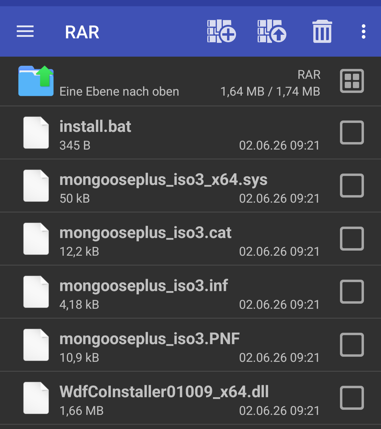

                    @Herving Of course I tried it first before I posted it here. The AV warnings are false positives. The update file is a self extracting archive which just installs the drivers from a Mongoose Plus ISO 3 on your computer. There is nothing harmful about that. But many AVs consider downloading .exe files from Google Drive as being suspicious, and also the behavior of the file is similar to some simple viruses. It creates a folder on drive C:/ and runs a .bat script with admin rights to install a new driver.
                    You can open the .exe with lots of programs like Winrar, 7-Zip or TotalCommander for example and you will see these files
                    You can also simply unpack those files to a folder of your choice and run the .bat as administrator. The result will be exactly the same as running the exe.
                    If your AV allows to report false positives, you should report the file as being harmless.
