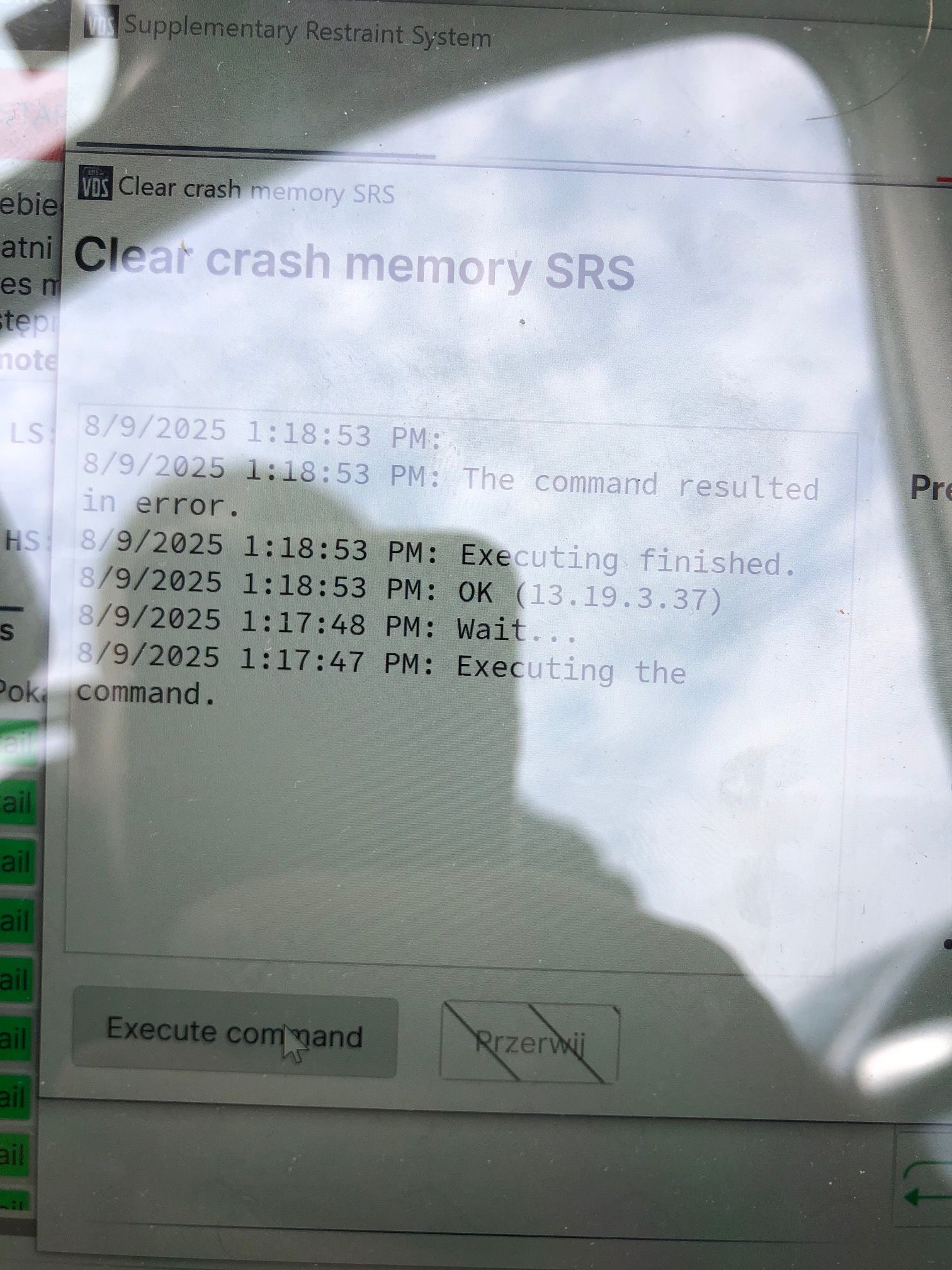

    I wanted to clear the SRS crash memory, but I keep getting an error. After completing the procedure, the error doesn't clear.
    All airbags have been replaced with new, working ones.
    There's only one active error (red) in the controller: SRS-B119343.
    The other errors are stored but not active (yellow).
    Can someone tell me what I'm doing wrong?!

        I did everything as described, and the airbags were replaced. Only one error code remained, SRS-B119343. I'm still having trouble completing the Clear Crash SRS procedure. The car is connected to a 12.2V charger.

          To reset crash date in SRS you need first reset locked BCM, this can be done by using the OBD system to clear the stored crash date in BECM then run again SRS crash date reset using Vdash
