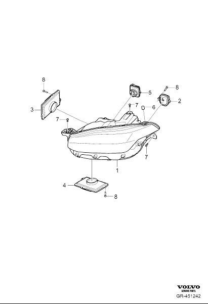

            @Searchy the HCM for your replacements should have part number 31468411. The original UK ones should have 31395944. So that might be part of your problem. I'm not sure if a software reload is needed when using used parts.

                  @SOpEL the modules needed for your EU headlights have the part numbers 31395943 (pos. 2), 31395944 (pos. 3), 31395945 (pos. 4), and maybe also 31395946 (pos. 5).
                  Without any guarantee that this is still correct.
                  Vdash can't perform software reloads/updates or configure headlights on SPAs. That's my last state of knowledge.
                  You might be able to clone the HCM software from your old modules with Vdash, but I can't tell you if this will solve your problems.
                  The software seems to be the same on all HCMs. At least the software number for a HCM reload is always 31472823 in my catalogue.
