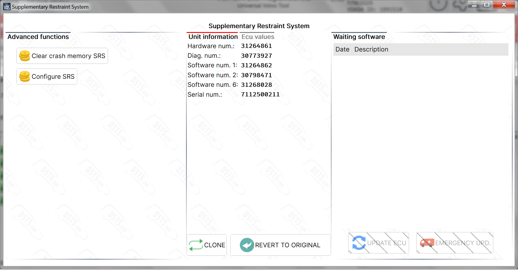

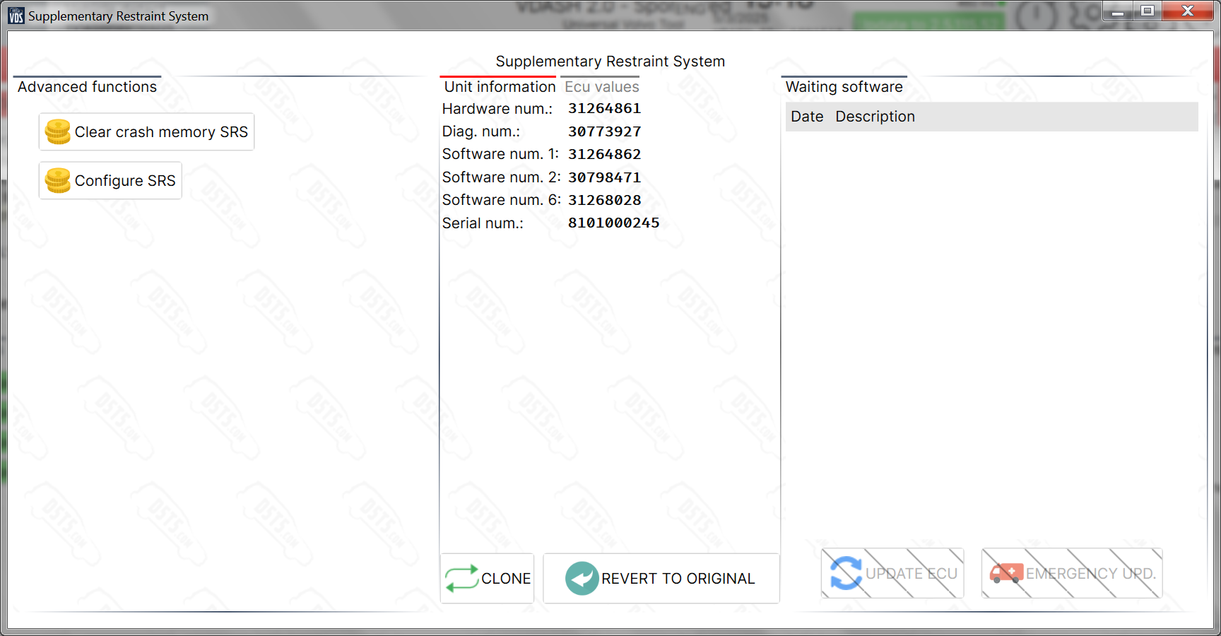

                Thank you @jv and @T5-T6-Schnappi. Below are screenshots of the SRS dialog box for 2 different modules which differ only by serial numbers. The software numbers shown are the same for both.
                @T5-T6-Schnappi would those be all the software numbers we need to check when trying to replace an original faulty module with a used module from another car?
                Thanks.
