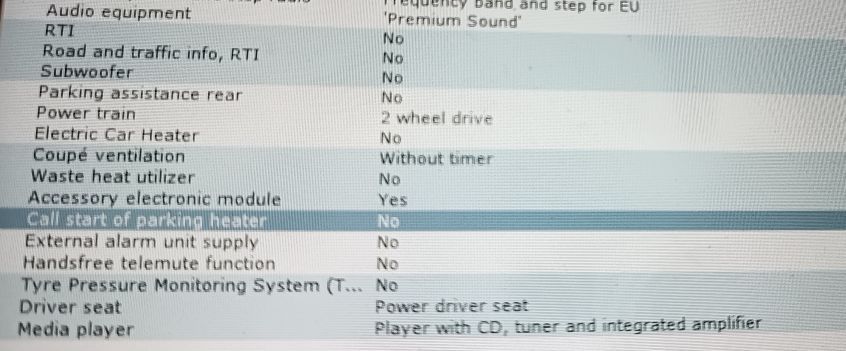

    Looking for remote start of the fuel heater my car has.
    My heater has a timer function and works as it should. It also has AEM module and what I have read grounding pin 3 from Aem start the heater.
    Only problem is how to enable
    "call start of parking heater function"
    I have not found that from vdash. I have flat subscription and pin code available. Picture is from vida.
      Look under Clima and Heating.,There are the options for remote preconditioning or remote fuel heater start. But I'm not sure if this is available/working for P1s.

        Thanks but there is only three options. I think Vdash people should activate that feature.
        Disabled
        Additional heater
        Additional with timer
          replied to Jannek on last edited by
          @Jannek I checked the manual for your modelyear. Your car doesn't support remote start. So it's correct that vdash doesn't show this option.

            Volvo has advertized that package to all p1 cars
            Aem+remote+software
            https://www.volvopartswebstore.com/products/volvo/Remote-start-timer-appl-Remote-start--fuel-driven-heater/1117414/30790219.html?srsltid=AfmBOooZwOAubxuwuz8XxEEwN8dnvcGu-ygaeuMy2UjaE_PCbE_BRCTO
              After checking the install instructions in VIDA, I think the software is needed for the AEM and has nothing to do with "call start" shown in the CSC tab. You might want to create a support ticket and ask if vdash is able to help you.

                I have made support ticket a few months ago.
                I have two AEM modules, other is from a car that has a working remote control. Both boxes send can commands when I ground pin 3. I think problem is CEM is not configured to listen that remote control command.
                • J Offline
                  J Offline
                  Jannek
                  Problem solved.
                  Software 30790219 loaded to CEM with vida, not to AEM.
                  Call start of parking heater changed and now I can start fuel heater with grounding pin 3. I use eberspächer remote controller.
