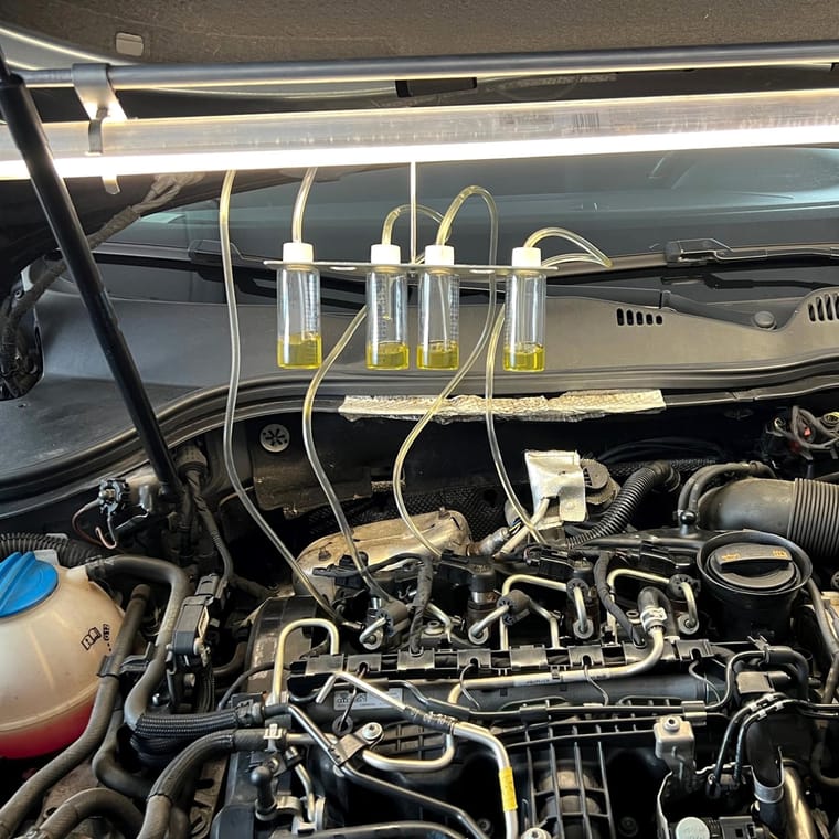

              @sizan I understand what you mean. Uneven combustion under constant or no load. This is usually caused by low fuel pressure, worn injectors, leaks or massive carbon build up in the intake . Did you already do basic things like clean the MAF and MAP sensors? Replacing the fuel filter? Use something like this 118537.jpg to check the injectors?

                  @Arnis2002 With checking injectors I mean performing an injector fuel return test, which can also be seen in the picture I posted. This simple test consist of unplugging the small fuel return hoses from the injectors, and watching and comparing the amount of leaking fuel of all 4 injectors while the engine is running. This simple test is an indicator to diagnose worn injectors, and can be easily done without removing them from the engine. Every professional mechanic I know, would do exactly this test together with a smoke test of the whole inlet, based on the symptoms reported.
                  Installing tuning software without doing a proper diagnose to fix potential engine problems is a somewhat special suggestion.

                    Injectors, among all, have been checked and they are ok..
