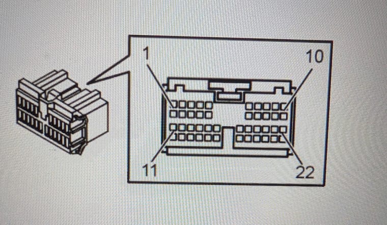

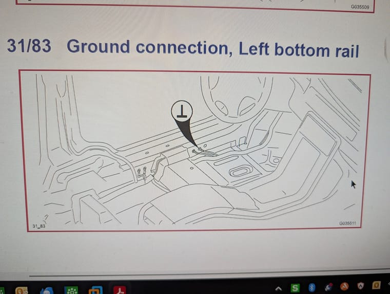

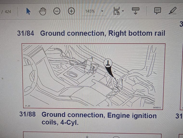

      @Phantom244 your error codes might be the result of water ingress from clogged sun roof drainages.
      You can check the grounds under the driver and passenger doors for corrosion.
      See here...
      But there usually would be more codes if those are corroded as there are several modules connected to those grounds.
      On cars with sun roof it's a known problem that water gets into the fuse boxes behind the glove box when the drainage is clogged. Your error codes for a to high signal from the humidity sensor that is located behind the rear view mirror and a code for a bad antenna signal are also indicators that water might have reached places where it doesn't belong to.
      A loose windscreen that lets water in is also pretty common on P3 Volvos.
      Are there really just the three codes you posted, or do you have more DTCs? Also temporary ones would be interesting.

        Hey @T5-T6-Schnappi,
        I'm currently on vacation and checked the ground points today – you can do that without a laptop – and they do indeed look fine. The tip about the damp windshield is helpful, as there are indeed traces of water on the inside of the windshield. Is there anything I can check at the fuse box? I have a small tool kit with me to remove the glove compartment. Could you perhaps take a picture of the connector I should be looking for? That would be great.
