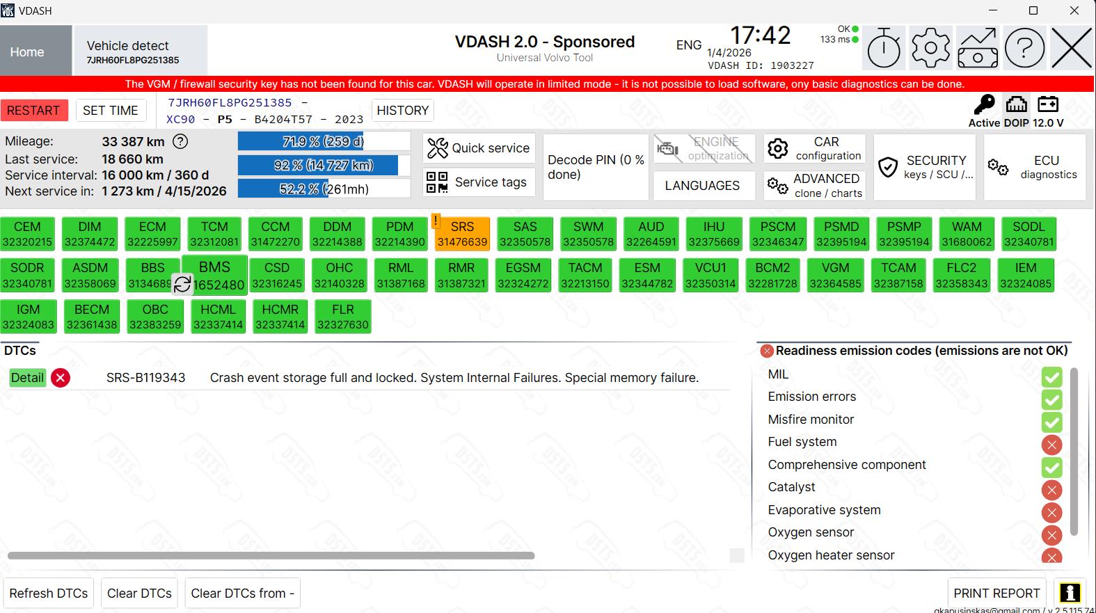

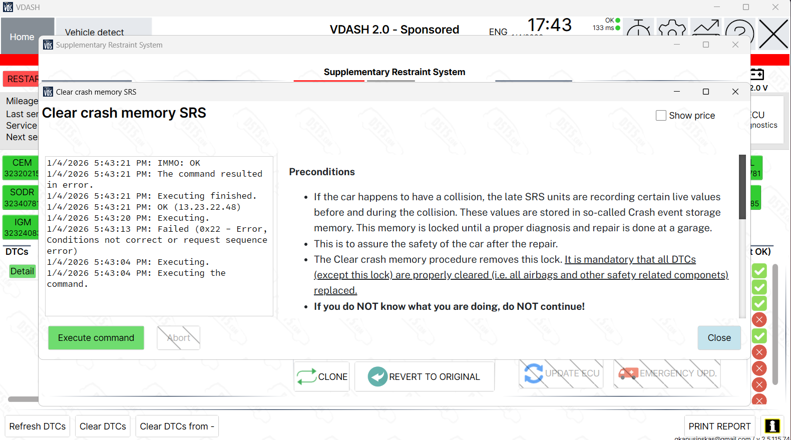

    We are working Volvo S60 2023 and we have successfully cleared all other DTCs in the car. The remaining fault is:
    SRS-B119343
    Crash event storage full and locked. System Internal Failures. Special memory failure.
    We don't know how to navigate this issue further or what other solutions might be there so I'd like to ask for any input. I will gladly provide any other information I haven't mentioned in this post.
    • J Offline
      J Offline
      joroartcorp
      I think the problem is in the red section describing the missing VGM/firewall key which is missing so VDash can do basic diagnostics only. But I might be wrong, as the screenshots are from XC90, and you are talking about S60...
