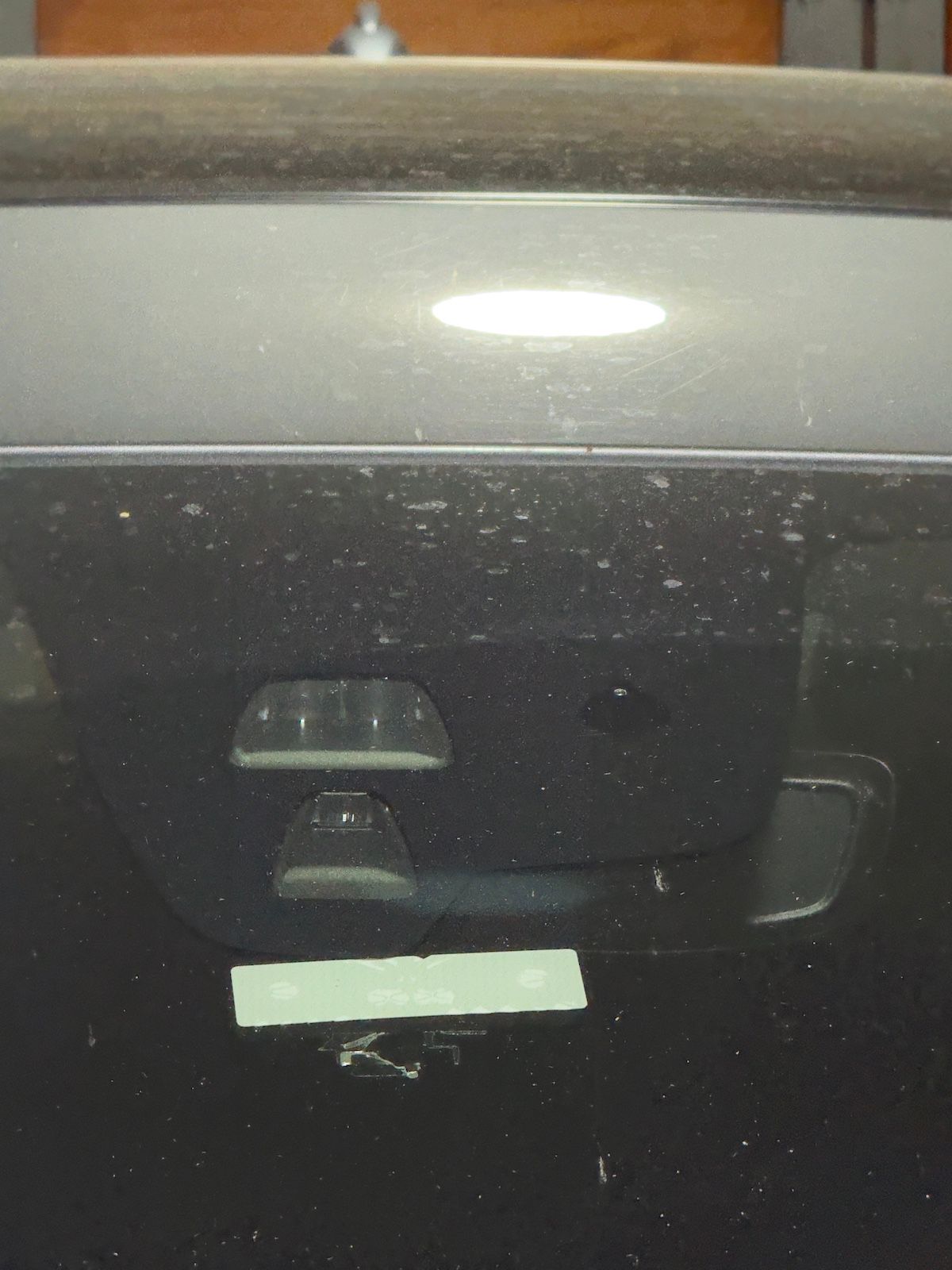

    @bochenn The VIN is not enough. It's not fully shown to other users, and even if it was shown in full, it would only be useful for users, who have access to a legit subscription of VIDA which is not possible for private users, except in the USA. You either have to connect the car to Vdash at least once, and then tick the box to add your car configuration when you make a post. Or you simply make a photo of the upper middle black area of your windscreen above the rearview mirror and upload it here. 119578.jpg This area. This photo is for example without the FSM.

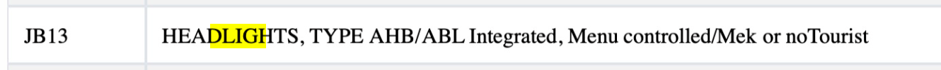

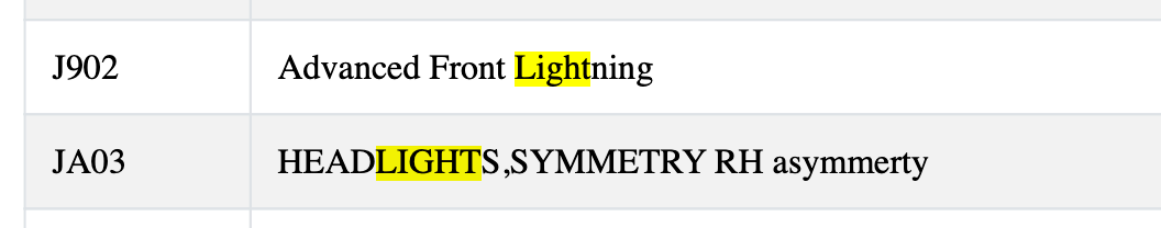

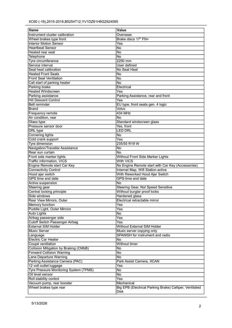

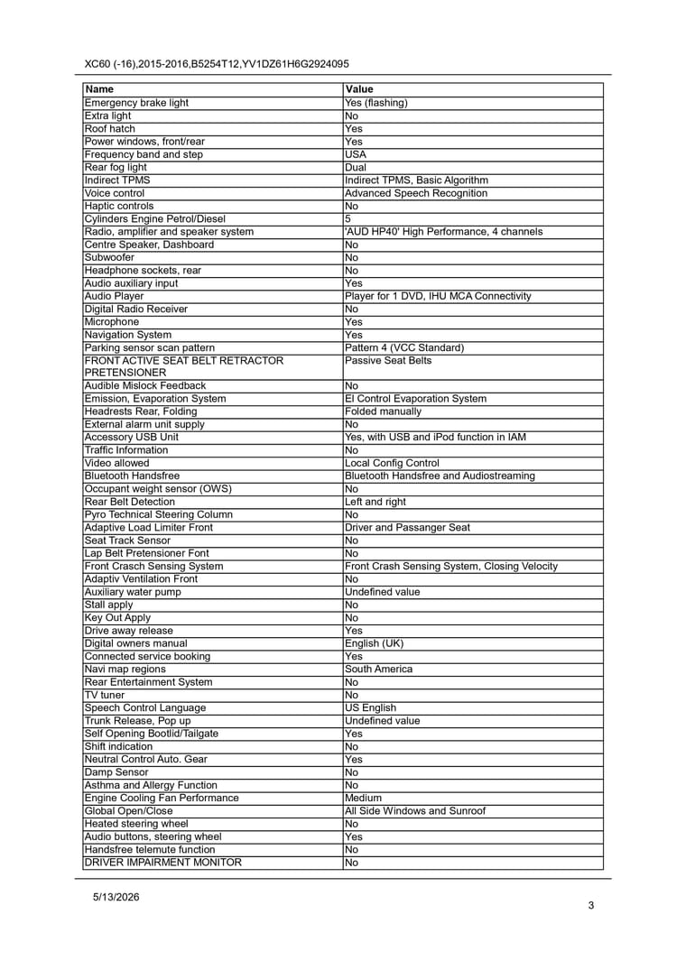

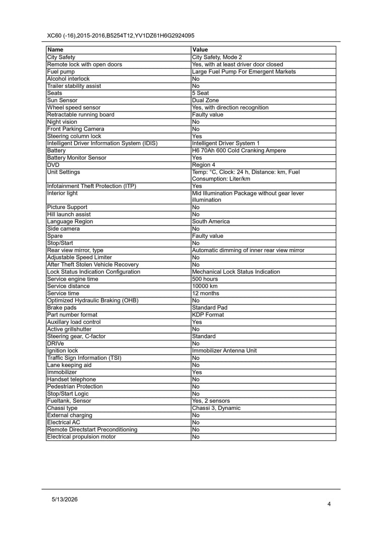

      2- A while ago I downloaded a sheet with all the features that comes with my car, I'm sharing with you as screenshots some of the lines that mention lights.

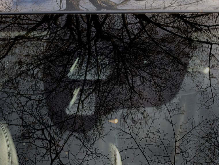

      3- Also I'm sharing a photo the upper middle black area of my windscreen. Can't tell if that has FSM or not. Also I can confirm it comes with Xenon HID headlights.

        @T5-T6-Schnappi, I forgot to add the photos.
          replied to bochenn on last edited by
          @bochenn By the look of your windscreen, I would say your car has the City Safety sensor, collision warning sensor and rain sensor, but no FSM.

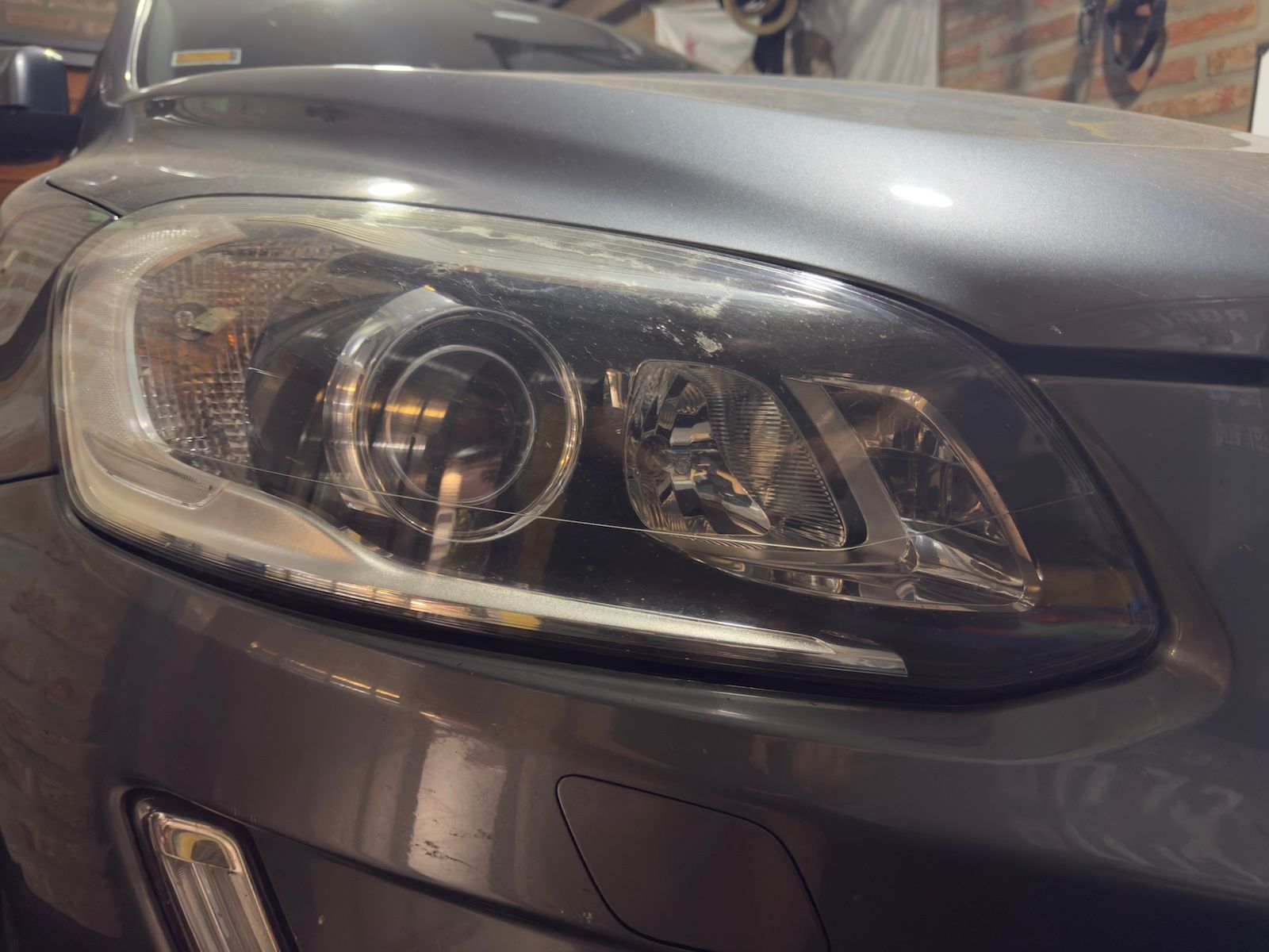

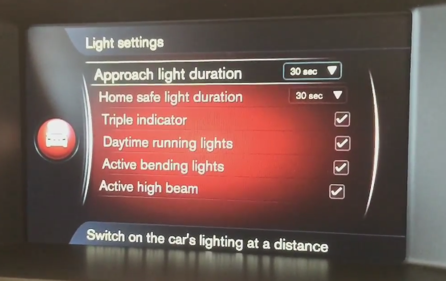

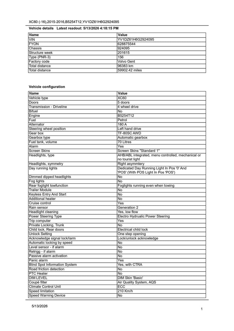

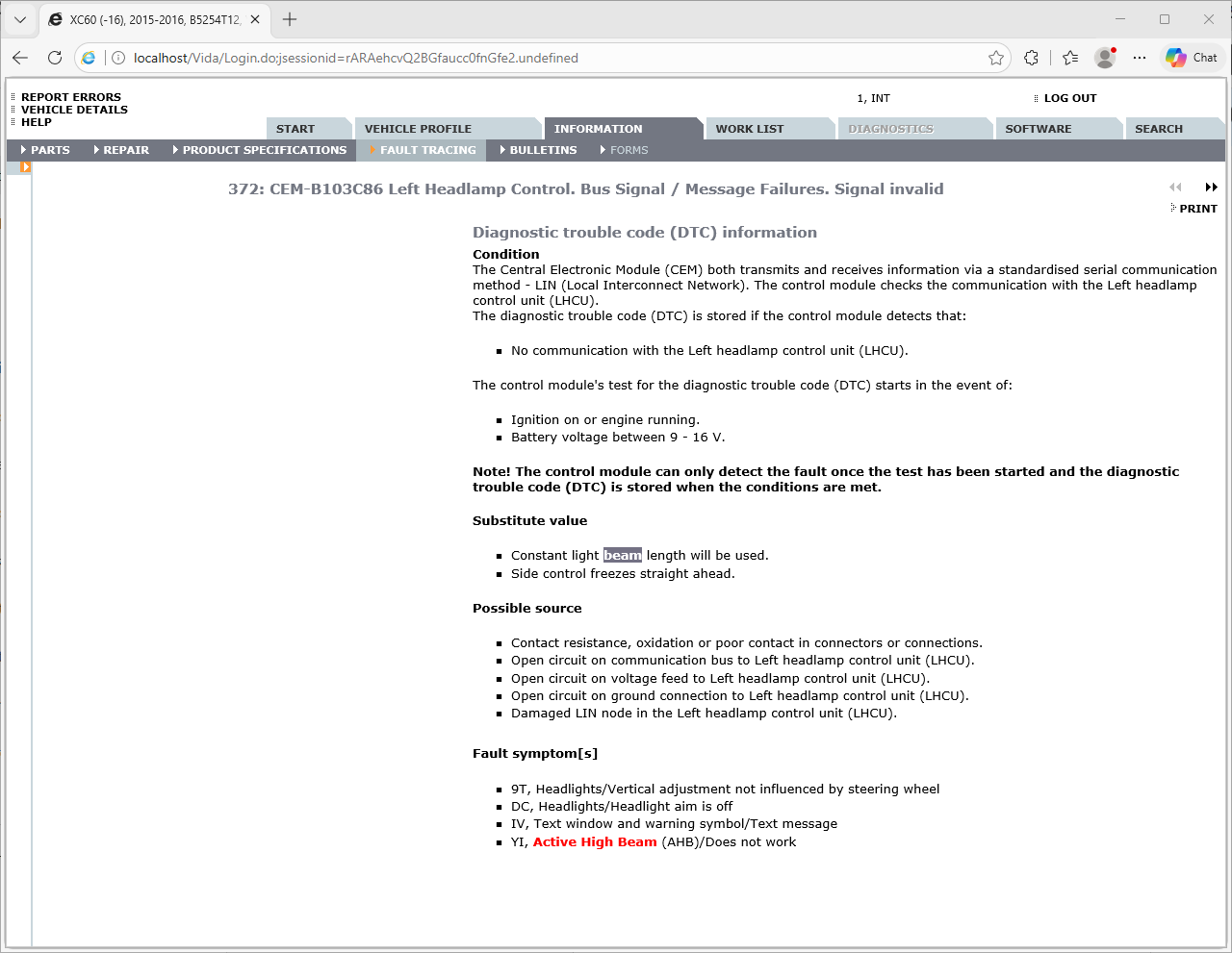

                Yesterday I connected my XC60 to VIDA and learned that Active High Beam is on the car but apparently is not working.
                I'm attaching a fault trace that I managed to get and the whole Vehicle details.
                I understand this might be out of scope of VDASH so if you can't help me is ok, at least point me on some direction to get this fixed.
                Thanks!

                  @bochenn The link has been changed to https://d5t5.com/sw/J2534_Driver_x64.msi
                  Check the connector at the headlight for corrosion. Also check for humidity inside the headlight. Remove the headlight and gently unplug and plug in the connector 2-3 times. It's also possible that your headlight is broken and needs replacement. Sadly this is quite common.

                    @T5-T6-Schnappi thanks! I'll look into it. Humidity I can confirm it doesn't have, I will check later if there is corrosion in the connector.

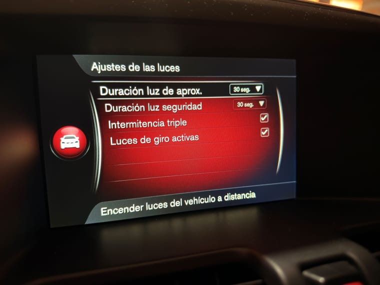

                    I compared my menu (in spanish) vs. the one I found online (in english) on some youtube videos and I don't have the setting to enable/disable the AHB. Also like the DRL, but mine are working correctly, maybe some settings are by default? All of this confuses me.
                    Thanks!

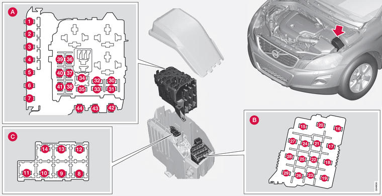

                      @bochenn after looking over your configuration I'm almost 100% sure that your car doesn't have a FSM and therefor no AHB. You don't have collision warning, traffic sign indication, lane keeping or adaptive cruise control which is a clear sign of "no FSM".
                      Do you see your headlights leveling themself when you turn them on? Maybe park in front of a wall and take a closer look. You should see the light going up and down right after you turn them on. If not, the leveling is not working which means new (used) headlights. The same goes for the bending light function. Turn the steering wheel and see if the light follows. You can also activate these functions in VIDA (Diagnostic/Vehicle communication/CEM/Activations) to test it. Also check fuse nr. 16
