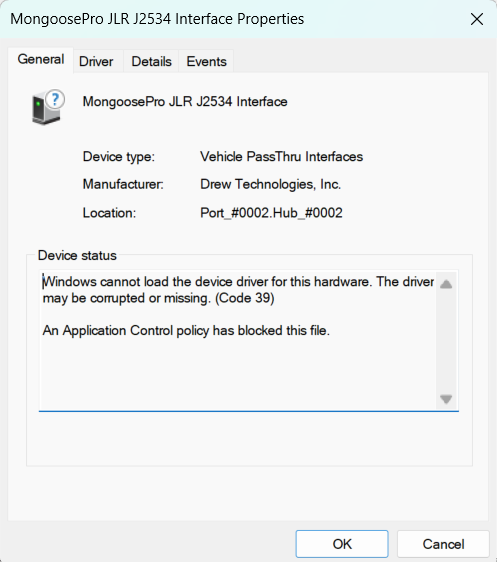

      Got the same issue on my personal laptop. And issue on clean windows 11 is that device is "in-use by other application/software"
      Dunno how those can be solved.
        Have you already tried to simply reboot Windows? Sometimes the driver gets blocked after I used Vdash on some of my computers. A reboot solves this for me.

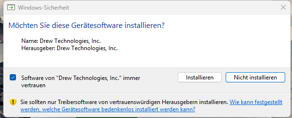

          @Naim uninstall the Mongoose drivers. Download and install the ones from here https://d5t5.com/sw/J2534_Driver_x64.msi
          and don't forget to tick the box in this dialogue

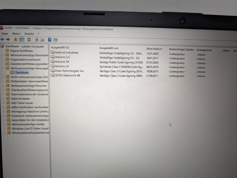

              You can also open the Windows start menu, type certmgr.msc and hit Enter to open the Certificate Manager and check if Drew Technologies is listet under Trusted Publishers.
              If this is not the case, you need to remove the drivers, maybe also the certificate under Untrusted Certificates, and reinstall them, and tick the box in the dialogue as I have posted it above.
