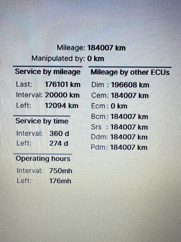

                                alt text
                                BTW this is what my mileage shows. I dont know if it will help for the problem solving and the correct fix to be applied, as the one for the DIM didnt worked.
                                Thanks in advance!
